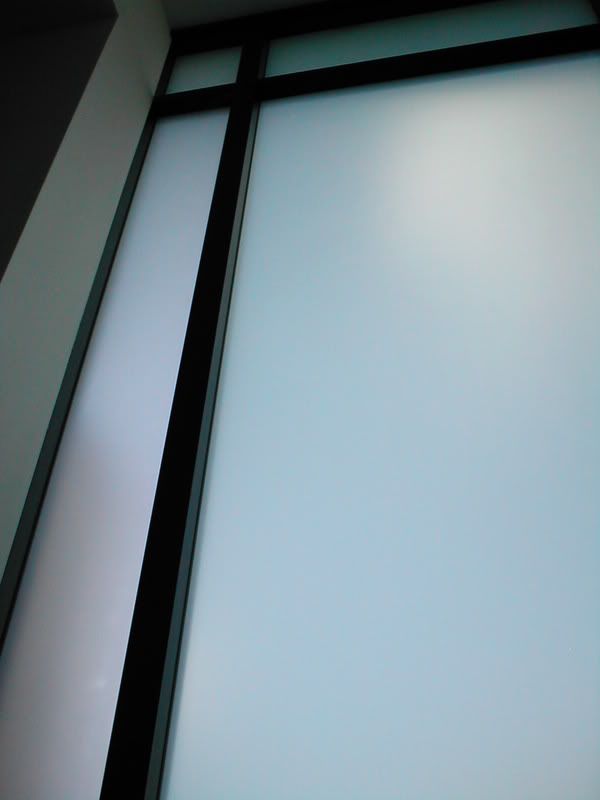

OK, seriously, I did a big azz window similar to that, mine was 75" wide, and 13' tall, granted it was in frost film, not solar but here's what I did :lol2
72" wide piece
4" X 13' strip
Finished product
72" wide piece
4" X 13' strip
Finished product

Well, If it was me, I'd lay the 72" piece, and then cut a strip about 1 1/2" and overlap it a smig, then trim it, and walla it's done, but what do I know, I'm just a midget man :lol2
