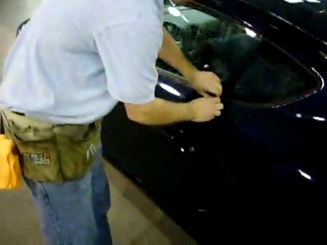

th_doorremoval.mp4
Has anyone here that paid for a professional training class ever been shown how to remove the film?  Removals start with the initial install.   Most installers are so afraid the film will lift they strip off all the wax or polish on the car so the adhesive will bite, or they may only use "the recommended" few drops of baby shampoo in their slip solution.  I've seen installs where ProBond was used in an inch wide smear around every edge.  Removing installs that have been hammered down nearly always result in hundreds of micro scratches or worse  from picking at the edges with fingernails or scrubbing off fossilized adhesive.
You want the film to slide off the car until pressure is applied and then feel the adhesive stick, ESPECIALLY on full panels like hoods and roofs.  The true perfect install is one that can easily be removed years later without damaging the clear coat finish on top of that paint.

Do you do a wax or a coating before installation like Proform was demonstrating?
Some of that depends on the film you're using and personal preferences, for example 3M recommends the surface be waxed with the exception of the edges prior to application when using their Pro series. I wipe everything down with 70% IPA before I apply ppf. I've done it both ways as far as waxed or not and personally skip the wax 98% of the time.
Best way to remove old film?  "Pay someone else to do it".  That's what I tell my customers.  When the insist on paying me, then I have to agree with both Speed and XPEL Jeff.  Wax before you install and pull at a low angle (I use Mechanix type gloves).
Steam is good but can also soften the clear coat, so use caution. For those films that come off in pieces, I sometimes use an eraser wheel - moderating a LOW RPM.  High RPM's melt the film and make a horrible mess.
